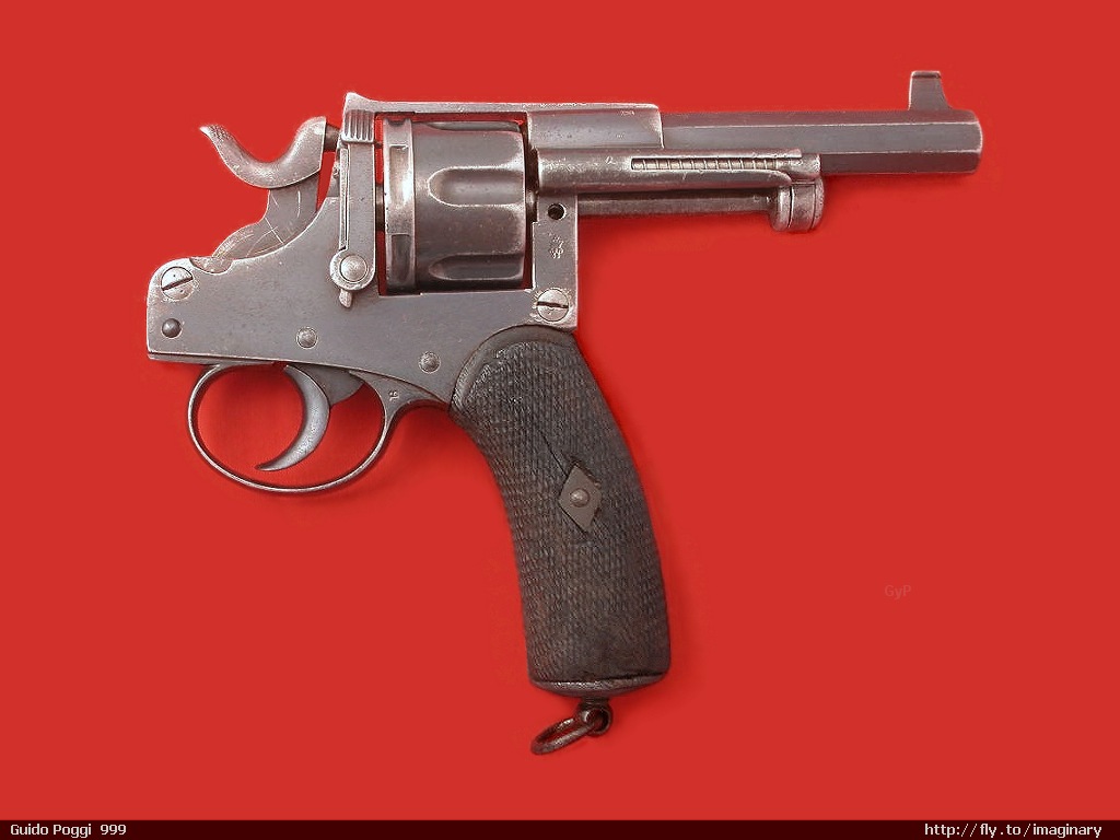

Steinar 01-30-2007 08:13 AM
..just be glad you didn't put it together like this ;)
http://forum.lugerforum.com/lfupload...pistol1024.jpg
