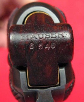

Found this on auction arms.. anyone have any thoughts?

Looks like a nicely refinished gun with a forced matched bbl. :thumbsup:

Ya, thats kinda what I thought.. The refinish does look like good work.

By "forced matched barrel," do you mean that someone got a replacement barrel, banged in the serial numbers, and then installed it?

Dont be such a sceptic,thats not forced matching its"some sort of a rework" ;)

bogus mag bottom
http://forum.lugerforum.com/lfupload...gbottomnot.jpg
This must be somebody who thinks he knows how to use alphabet and number stamps... not an original mag bottom IMHO. Mauser would have put their logo on a commercial item... not spelled out their name like this.
