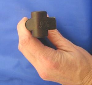

Anyone seen another one like this ?
Paticularly of interest to me are those "9 m/m" stampings...have folks seen this style on other magagines before ? Any book references ?
http://cgi.ebay.com/WWI-Luger-Cal-9M...QQcmdZViewItem
http://forum.lugerforum.com/lfupload/kontos_mag_2.jpg
http://forum.lugerforum.com/lfupload/kontos_mag_1.jpg

9m/m script magazines are found in 1902 Fat Barrels, 1906 Commercial and AE, and 1906 Russian. It is a commercial magazine. I haven't seen a 9m/m Navy before. I am pretty sure you will find them referenced in most Luger books.
Dwight Gruber 11-25-2005 02:28 PM
Kenyon (p.92) notes that some 1906 Navy Commercials were provided with magazines like this.
drbuster 11-25-2005 03:16 PM
One pristine commercial Navy changed hands at the recent Reno show with such a magazine.
luger11 11-25-2005 03:17 PM
Hi Pete.....It should read............Cal. 9m/m on the mag bottom. I do not see the "cal." on this particular mag.

A good point, and one I glossed over in my Kenyon reference (he does, indeed, say "Cal. 9m/m".

Ron Wood 11-25-2005 09:22 PM
He says it has "Cal 9mm" on the bottom, but darned if I can see the "Cal".

I thought it should read "Cal 9m/m" as well...
Ed...the trouble with whiting (and now...your yellowing) is you cannot see the real nature of the stampings underneath...;)

I'm curious to know how the 9m/m compare to the stamping of an original. I've gone through my library and can't find a picture of one, anybody got one they can post?

Whoa Nellie! If I am not missing something, I was under the impression that the Navy commercial originally had the "Cal 9mm" stamped on the bottom of a commercial non-concentric circled magazine! I have never seen or heard of such a stamping on a "real" concentric ringed magazine. And yes, it SHOULD have the "Cal" there. The 9mm stamping looks very sharp and fresh and with the previous caveats regarding the seller, I would look at this magazine with utmost suspicion and doubt at to its originality.

According to Mr. Kenyon on page 92 of his book LAR the wood bottom is concentric ringed.

You will find Cal 9MM on both type mags if you examine enough samples.

Tom Armstrong is absolutely correct and Mike Krause concurs. He also said that the "9mm" without the associated "Cal" should be viewed as highly suspect.

Do not forget we know of a fellow that sells nice "Cal 9m/m" wooden magazines from the MO area as well...(i.e. NOT Tom Heller...). I think you even have a copy of his order list...
Nice, new sharp stampings in the wood should typically be the tip-off...
