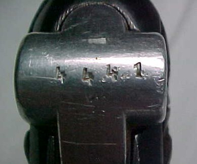

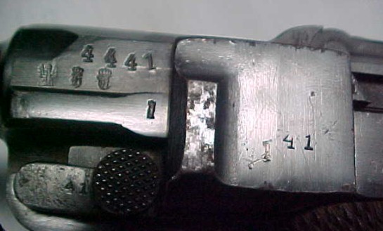

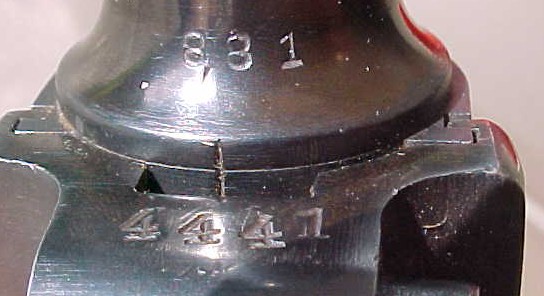

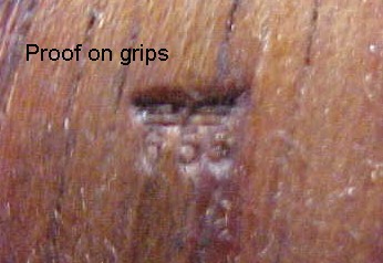

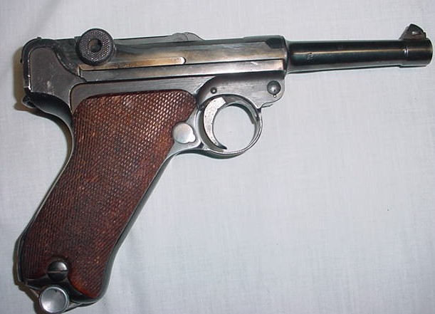

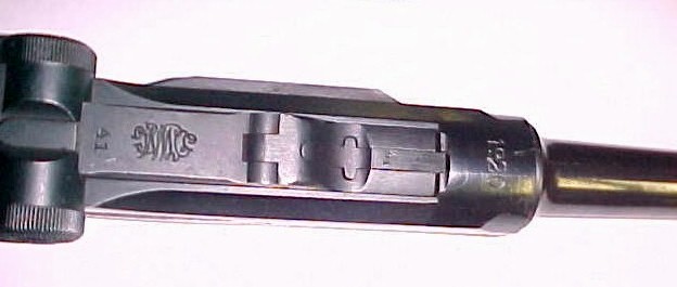

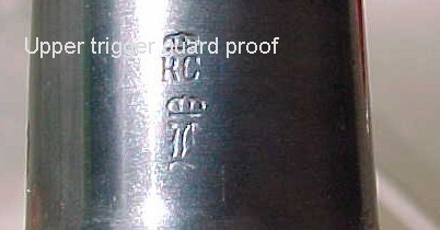

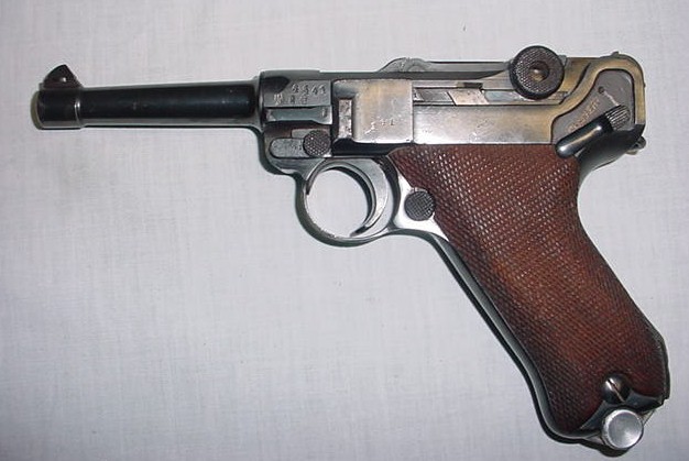

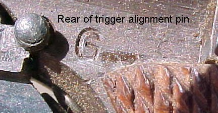

Hey, please I need help. I have this Luger for only a few hours. I have been trying to buy this Luger for a long, long time. In fact, it belonged to the man who originally captured it in the big war, but that story will take to much time to tell. What is important is that his widow and son have allowed me to ask the forum membersâ?? opinion of exactly what kind of Luger it is in order that I might make a fair offer. I suggested that I take it home and provide as many pictures as possible to get a good idea of just exactly what it is. So with that, I am asking your help in telling me what it is and the condition. I am fairly certain it is 1920 Police, but I need another opinion to keep everything on an even keel. Almost everything including the magazine is matching except the hold open latch and it seems to be over stamped. You help is greatly appreciated. Sorry about so many pictures !!! Thanks, Mikehttp://forum.lugerforum.com/lfupload/police_copy1.jpg http://forum.lugerforum.com/lfupload/policea_copy3.jpg http://forum.lugerforum.com/lfupload/police2.jpg http://forum.lugerforum.com/lfupload/police5.jpg http://forum.lugerforum.com/lfupload/police3_copy1.jpg http://forum.lugerforum.com/lfupload/police4.jpg http://forum.lugerforum.com/lfupload/police6.jpg http://forum.lugerforum.com/lfupload/police7.jpg http://forum.lugerforum.com/lfupload/police8.jpg http://forum.lugerforum.com/lfupload/police9.jpg

Mike, I wouldn't say it is a police? A 1920 Reichswehr marked army is what I would say from an imperial (see the RC markings).
The grips are ww2 replacement, i.e. the Eagle 655...
Value is hard to say, the close ups of the left side make it appear a bit beat, but the not so close ups, make me think $700-$800?

I'd take it, anything over $600 is fair, although I have paid less for a nice gun the last couple of years, and paid more too!
Numbers all match? What is the magazine have on the bottom? + or a number besides the serial number?

I though the RC Crown proof was an arsenal proof? Yes, I caught the grip replacement. Thanks for the input. Mike

Very interesting. To answer your question about the magazine, there is a proof mark under the number. There is also a scrip "n" not like the lower case letters found on serial numbers. Also the barrel apparently has been changed on this Luger. I would think that is part of some arsenal rework correct?
Dwight Gruber 07-19-2005 10:33 PM
Mike,
Definitely a Weimar parts/rework.
The barrel mark is described by Costanzo as a Simson military surplus parts proof, seen on 1933 reworks of WWI military and commercial models. Is there a serial number on the bottom of the barrel, or just the barrel guage? Any other barrel marks?
It is not clear where the "upper trigger guard proof" is actually located; this is crucial to determine the origin of the gun--if it really is on the frame it indicates the frame itself is of Erfurt manufacture. There is no evidence on the frame that the holdopen was added after manufacture (a "white" pin end and an inspector's mark), reinforcing the thought that the frame does not originate with the receiver.
The receiver is a DWM First Issue Military, this is determined by the military inspection and proof marks being on the left side of the receiver. The serial number was added there later. First Issue DWM were numbered in the commercial--hidden--style. Take the gun down and see if there are numbers on the underside of the center toggle link, the left side of the breechblock, and the bottom surface of the receiver locking lug. The numbers, if present, will represent the original serial numbers of these parts. Are there numbers on the bottom edges othe sideplate and takedown lever?
Is there a number stamped on the rear toggle pin? If there is it will help determine when this pistol was reworked.
The absence of a sear safety is a strong indicator that this Luger was not in police service. Actually, the story of its capture might provide a clue as to its origins.

Thanks for your very informative reply. There is a serial number on the underside of the barrel. There are no other barrel marks. The proof marks on the trigger guard are on the inside of the curve just below the serial number. They are certainly on the frame. I check all the areas you suggested with a jewelers loupe and there no other number to be found. The hold open latch was over stamped it appears. Where all the other parts are "41" it is "18" but then stamped "41" over the "18"
