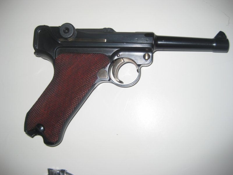

Rich T 01-26-2017 08:33 PM
’36 s/42
1 Attachment(s)
Has issues. Am not willing to wait on repairs, nor spend a few hundred on it. Not numbers matching, and unsafe to use at this point. Refinished, pretty..and an original mag... plus 2 repros.
having issues with it (admin added and moved)
http://forum.lugerforum.com/attachme...1&d=1485477162
