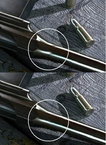

Absolutely beautiful! One small comment...there is no step in the barrel of a conehammer, unless the barrel has been replaced. The step is found on a Model 1930.

P.S. Typical! - Ron had to make a comment, but the ring on your diagram does not show on the surface. However, for accuracy, the ring should be eliminated.

Ron Wood 09-21-2008 12:01 AM
Vladimir,
I understand that there is no "dog leg" like the Model 1930, but on a conehammer there is no "ring" or "step" in the barrel. It is a smooth transition. The photo that I assume that you used for your 3D drawing has had the barrel replaced so there is not a smooth contour. The barrel should look like the bottom re-touched image:
http://forum.lugerforum.com/lfupload/barrel_comp.jpg

Makarov 09-21-2008 12:12 AM
I understand and complies with you.
