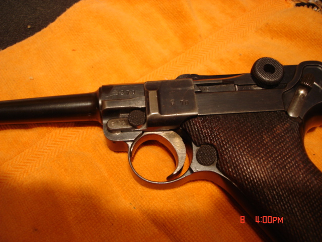

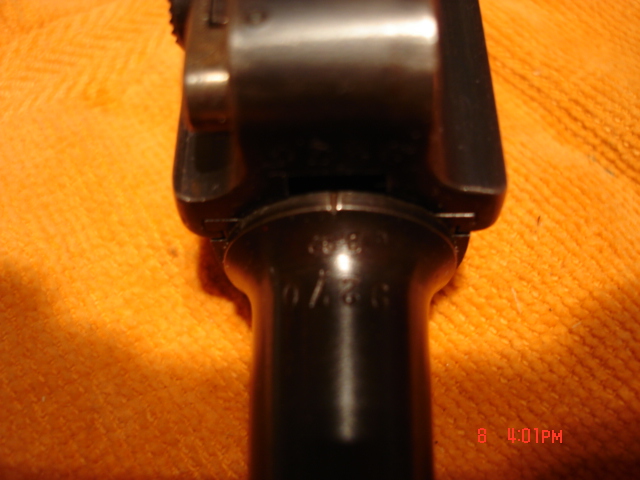

TAXRX 01-08-2008 05:15 PM
http://forum.lugerforum.com/lfupload/9270toggle.jpg
http://forum.lugerforum.com/lfupload/9270left.jpg
http://forum.lugerforum.com/lfupload/9270rite.jpg
http://forum.lugerforum.com/lfupload/9270barrell.jpg
Heinz 01-08-2008 09:49 PM
Nice pictures :-)
Edward Tinker 01-08-2008 11:45 PM
hey, thats a Simson :)
my records show #9270 has a matching magazine. I am guessing I found the information from a dealers listing, because I have no name associated with the record (I don't ever share that info btw)
TAXRX 01-09-2008 09:11 AM
yes it has a matching mag. how far back is your database? I have owned this one since 2000.
