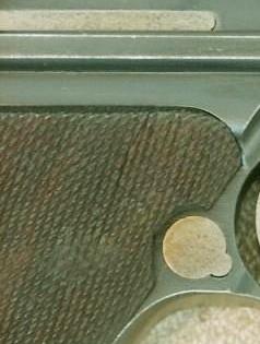

Is the somewhat irregular shape of the polished area at the thumb safety worrisome to you...especially along the upper edge ?
http://forum.lugerforum.com/lfupload/m2_1.jpg
http://forum.lugerforum.com/lfupload/m2__3_copy1.jpg
Ron Wood 11-24-2007 10:47 PM
Yep...a little. But it doesn't look like a run-out made by a tool, too irregular. The polish is nice and uniform with evidence of a constant feed on the cutter. If it had been hand polished or the cutter wavered, you would expect a broader arc on the run-out. A bit worrisome but the rest of the polished area looks pretty good and has a nice patina. Have to give it at least a half thumbs up.

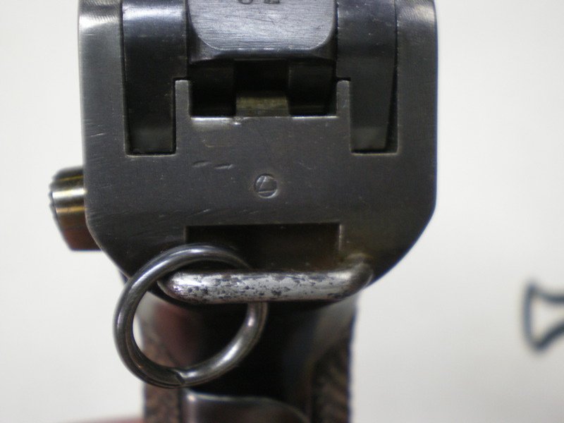

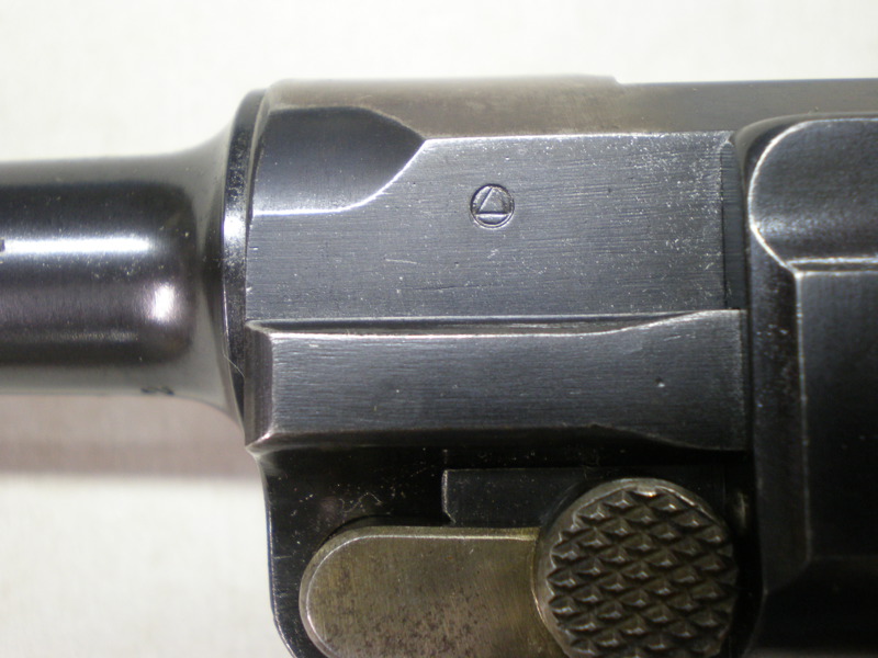

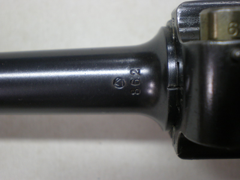

Could I impose on you to provide more close-up photos of the triangle/circle proof marks on your luger in the following areas :
1. Underside of barrel.
2. Back of frame.
3. Left side of the receiver.
From your previous photos, it appears your proof marks have a "halo" around the stampings.

Okay, if you go back to my gallery, I posted these pictures.
http://gallery.mac.com/petergalloway#100013
There is definitely a halo on the barrel and the back of the frame. I don't see one on the receiver though.
So, is a "halo" a good or dad thing? It suggests the proof stamp was done after the rust blueing.

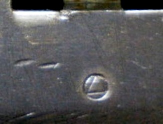

Here is one of your photos, zoomed in...I keep thinking I see a Swiss cross proof on the back of your Luger...which is certainly not the case...just the limit of zooming in on the photos you have posted so far...
http://forum.lugerforum.com/lfupload/m2__2.jpg
Ron Wood 11-26-2007 01:26 AM

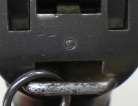

Here is one of the last photos that shouldn't take too much manipulation to see the halo, and there is no evidence of a Swiss cross.
http://forum.lugerforum.com/lfupload/backframe.jpg

Looking at in in the flesh clearly shows a halo around the barrel and frame proof. The one on the barrel does not completely surround the proof as one would expect since it is on a curved surface. It is most heavily evident on the left left side of the proof where the imprint is deepest and thus most metal displaced. PB250005.jpg shows this.
The one on the frame surrounds the proof, but heavier on the top where the imprint is deepest (PB250006.jpg).
Curiously the receiver proof shows no halo, but reflecting light clearly shows raised metal around the perimeter, so the metal in that are has not been tampered with. I'm gong to take an educated guess here and say that it looks like the serialization is done in the white, but the proofing is sometimes done after rust. Thus the receiver may have been proofed before rust.

If I did this right, here are the photos:
http://forum.lugerforum.com/lfupload/barrel_copy2.jpg
http://forum.lugerforum.com/lfupload/frame_copy3.jpg
http://forum.lugerforum.com/lfupload/receiver.jpg

Thanks, Peter...for the great follow-up photos.
If the concensus is that your gun has its original finish, then the defacement of the chamber crest is most unfortunate...as Ron Wood said...your gun is a remarkably well-preserved M2.
On many M2 guns, you will see a "bruise" in the wood along the right-side grip panel...just to the left of the magazine release spindle. This is usually caused by the gun being in the AE holster and having contact with the back-side of the metal closure stud on the inside holster body.
http://forum.lugerforum.com/lfupload..._m2_bruise.jpg
The reason for why the M2 crest was removed is still the mystery and I still think it would narrow the collector-interest in your gun...
The sequence of when proofs are applied and whether before or after bluing is quite a volatile area of study.
I do not think DWM applied the same methodology to all the guns they made.
It is very likely the M2's (maybe in the under 1000 SN range) had some of their proofs applied after bluing and other guns in the later contract had their proofs applied before bluing.
On some of the DWM-Swiss guns, you will always see the chief inspector's stamp on the left side of the receiver done before bluing, but you will see other smaller Swiss cross stamps and EB stamps applied after bluing.
On guns with "Germany"...you will see M1900 and M1906 guns with both halo and no-halo around those "Germany" stampings. Which is right and indicates an original finish ? ( I think both may be right...).
I think the variablity in stamps with halos and without halos may have been dependent on whom the inspectors were (either in-house at DMW or coming from a foreign country) or if an outside proof house was used or where the batch of guns in production were on the assembly line and if the inspector could be scheduled in time to do his/her inspection before the next production steps, which may have been the bluing process.
Lots of variables to consider.
