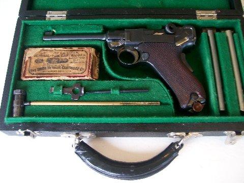

Eric asked me to post this photo of his US Test Trial Luger and Rock Island Arsenal holster for him.
http://forum.lugerforum.com/lfupload/testdisplay2.jpg
cirelaw 05-15-2007 08:30 PM
ERIC, I have taken some detailed photographs and closeups of the test Luger, serialed number #6786, and the rarest US test holster. one thousand were manufactured for the ROCK ISLAND ARSENAL, It is reported in '1900 LUGER, Publised by MICHAEL REESE II, and distributted as follows, 10 to United States Military Academy, 15 to the Presario, San Francisco, 10 to Fort Hamilton, 40 to Fort Ridley, 5 to each commanding officer of the 185 troops of our cavery, for a total of the 1000,I would invite any comments or inquiries. My question was who produced the 200,000 rounds of ammunition, and where can i find a box, a Luger with a great tail.

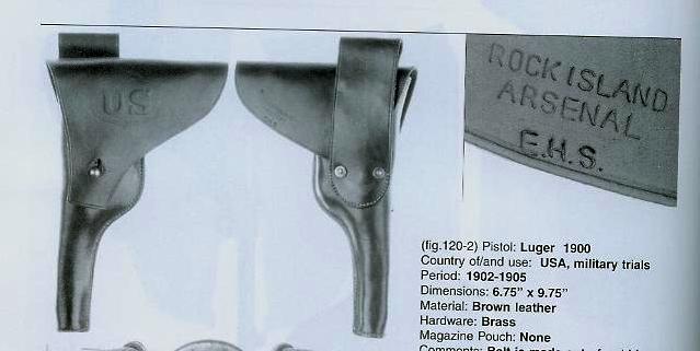

I have owned two TE holsters, the one pictured in Vanderlinden's book and another that I passed on to a friend. One had the initials on the flap and the other did not. Other than that, they were exactly alike in all respects down to verdigris and smell.

Photo scan of the holster George mentions he owns and is shown in the new book by Vanderlinden :
http://forum.lugerforum.com/lfupload...st_holster.jpg

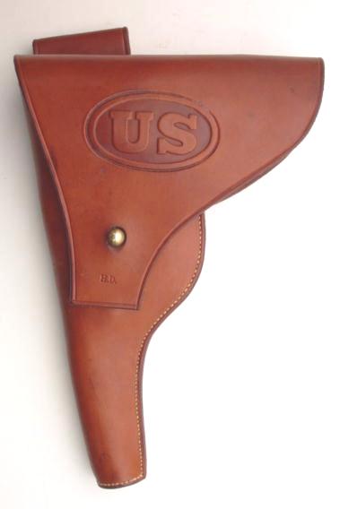

Photos of a repro TE holster made by El Paso Saddlery of TX...these early ones were made without the El Paso stamping on the back :
http://forum.lugerforum.com/lfupload...er_1_copy2.jpg
http://forum.lugerforum.com/lfupload...er_2_copy2.jpg

The El Paso Saddlery holster is a nice copy in overall configuration, but has sorme easily spotted differences. The RIA marking is stamped much higher and does not match the original exactly (character spacing, particularly "ARSENAL", is different).

Flap hole in the "repro" where the stud runs through does not seem to be of a tear-drop shape on the EPS offerings...

I forgot, the Luger has a serial number, #6786 both frame and matching barrel, and and a wooden bottom barrel, unnumbered and marked only with a 'flaming round bomb', that I will provide a sample, Its seem to me to be the easiest wooden mag to counterfeit,
