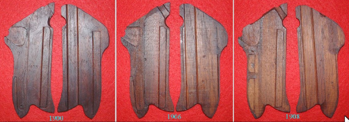

In the "Need info on a Portuguese Luger" thread, Norm asked for photos of 1900, 1906 and 1908 grips. I'm glad that Norm raised this topic because I am sure there are lots of new folks that aren't aware of the basic differences between "Old Model", "New Model" and grip safety vs. non-grip safety grips. So here are the photos Norm requested:
http://forum.lugerforum.com/lfupload/00_grip.jpg
http://forum.lugerforum.com/lfupload/06_grip.jpg
http://forum.lugerforum.com/lfupload/08_grip.jpg

Ron, Exc photos of the inside of these grips. You might also note the the checkering become courser after 1913 when the rear of the PO8 grips were extended to line up with the added stock lug. TH

Regarding the 1900, would they look the same for a 1900 AE Test?
Ron Wood 05-08-2007 12:23 AM
Yes. A 1900 is a 1900, it doesn't matter what is on the chamber. The type of grip is determined by the configuration of the mainspring, and all 1900s have a flat mainspring.
After I posted this answer, I realized that the question that was being asked may not have been about the physical configuration of the grips but the markings. The purpose of the photos is to show how the grips are machined...the markings are another topic entirely.

Would it be too imposing to ask for the addition of photos of the external surface to show the finish quality over the few years as mass production increased at he cost of material and finish, Which appears to me to be quite evident as to grain quality and density and course tool marks remaining on the finished products?

Excellent photos of the grips. However,for comparison purposes, If the grips were positioned next to each other it would made comparison much easier. i.e. all three right grips next to each other and left grips next to each other so you don't have to scroll up and down looking at each detail.

I sent you a composite of Ron's grip photos...rights and lefts side-by-side.
You can post it up if you like...
Edward Tinker 05-19-2007 04:17 PM
1 Attachment(s)
a poor atempt...

I do see the difference on the right grip of the 1900 vs the 1906. The left grip is pretty closely the same except for the very top, just above the cut out for the magazine release button. Is the view of the 1900 showing that wood has been removed in that area or is that camera lighting? I guess that what I am asking is the left grip the same for the 1900 and the 1906?
Now the opposite is true between the 1906 and 1908 in that the right grips look identical. But the left grips are different as would be expected given the removal of the grip safety and maybe a change in the thumb safety.
I guess that I will have to take a 1900 and a 1906 apart to really see why these changes were done. I will also take an Ideal set of grips to see how they compensated the metal back plate for the difference between the 1900 and the 1906, if there was an adjustment at all.
Thanks Ron for the pictures and thank you Ed for the composite. Both you guys did yourselves proud. :cheers:

Thanks Ron ... much needed and answered some questions I had regarding this subject. :bowdown:
Here is my version of Ron's excellent grip pics ... hope no one minds :p
Attachment 85237
Pretty much same as Ed's but his only shows 1/2 the pic in his post, If you click on ed's pic it comes up full screen and all there.
