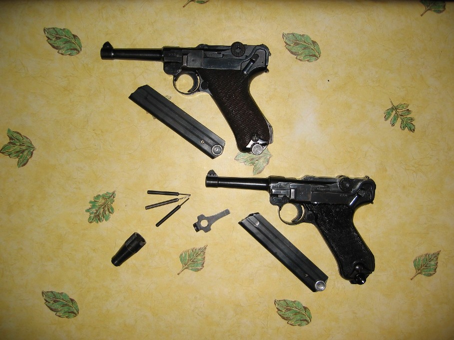

Here are 2 2WW lugers:
42 1940
byf 42
http://forum.lugerforum.com/lfupload...2wwreduced.jpg
