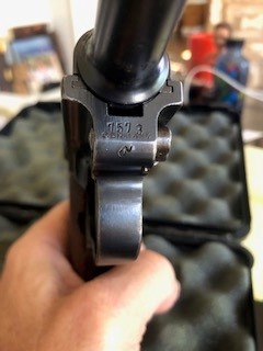

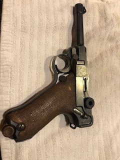

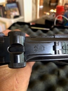

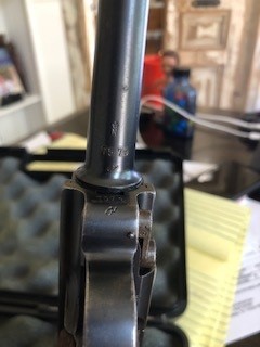

Gents, Recently came into possession of a Luger. It is a 30 Luger SN 7573. Pics are attached. The only other mark is what looks like an "N" on the left side with something over it. Wood handles and wood clip end. Let me know what else you might need to help id and age. Thx.

Kurgen/Jerry, your pistol is a typical civilian-market pistol commonly known as an “alphabet Luger.” They were made in the mid to late 1920s. The “Germany” stamp indicates yours was intended for sale to the US market. They’re one of the most common Lugers found.

I can't make out the letter suffix.....it is part of the serial number and gives us an idea of when it was made.

@Kurgen I think you have 7573 o ("O" see DWM suffix chart below)
The suffix is only found under the full serial number on the frame front.
The crown/N is a commercial nitro firing proof. It's usually only on the left upper receiver, but sometimes more than one will be applied to the receiver and barrel.
