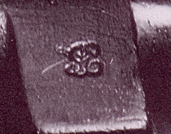

Vlim 08-16-2005 02:11 PM
Blowup of a GL-stamp on a magazine.
Borrowed from John Walter's 'Luger story', page 66. Original Photo is from dr. Rolf Gminder's collection.
http://forum.lugerforum.com/lfupload/gl.jpg

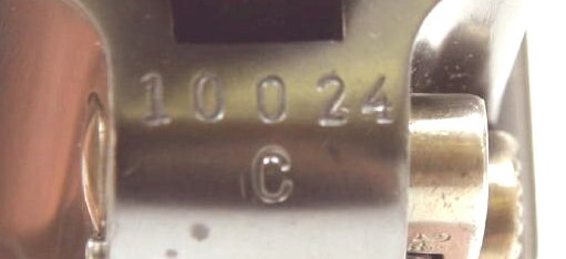

Pete Ebbink 08-16-2005 02:17 PM
Harry,
Do not have a gun to photograph...but here is a photo scan of a page from Walter's book "The Luger Story" on page 68...
http://forum.lugerforum.com/lfupload/presentation_1.jpg
And here is a close-up of one of the photos of your luger you posted on Jan's Gun Board...I think the style of the "1" and the "2" are quite different between the two photos...
http://forum.lugerforum.com/lfupload/harrys.jpg

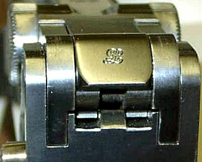

Pete Ebbink 08-16-2005 02:41 PM
Harry,
Here is a glimpse of your "double strike" of the GL on the rear toggle.
http://forum.lugerforum.com/lfupload...uble_stamp.jpg
I just cannot imagine either a prototype (for show and tell to prospective, important customers...) or a presentation luger (to some VIP dignitary...) could possibly pass DWM final inspection and leave the factory as a double-strike...:confused:

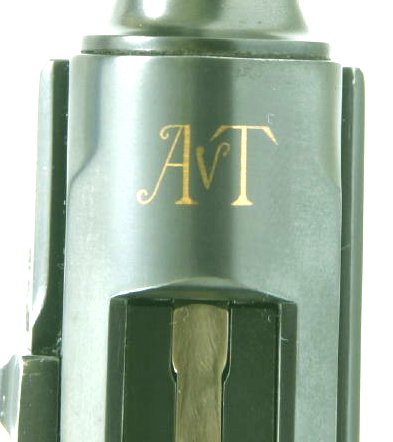

Pete Ebbink 08-16-2005 02:55 PM
Jerry B.,
Here is a close-up and lightened photo I borrowed of Harry's AvT chamber marking from the postings on Jan's Gun Boards :
http://forum.lugerforum.com/lfupload/avt_chamber.jpg
