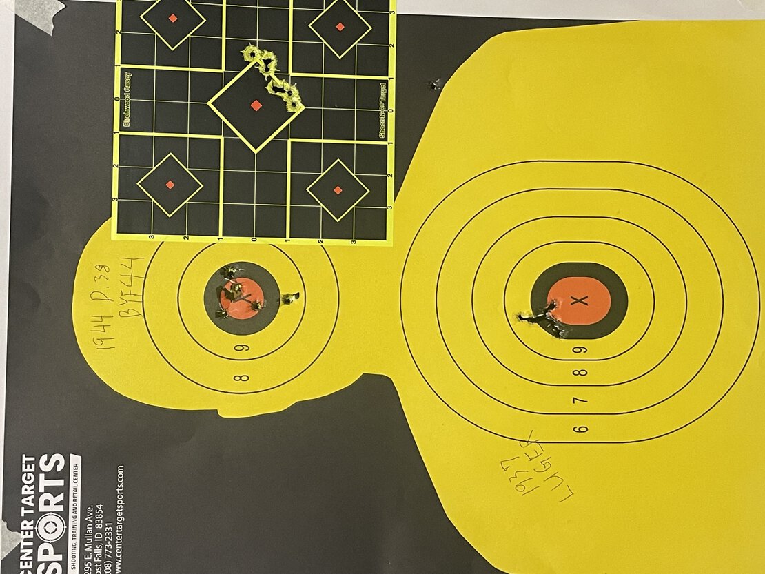

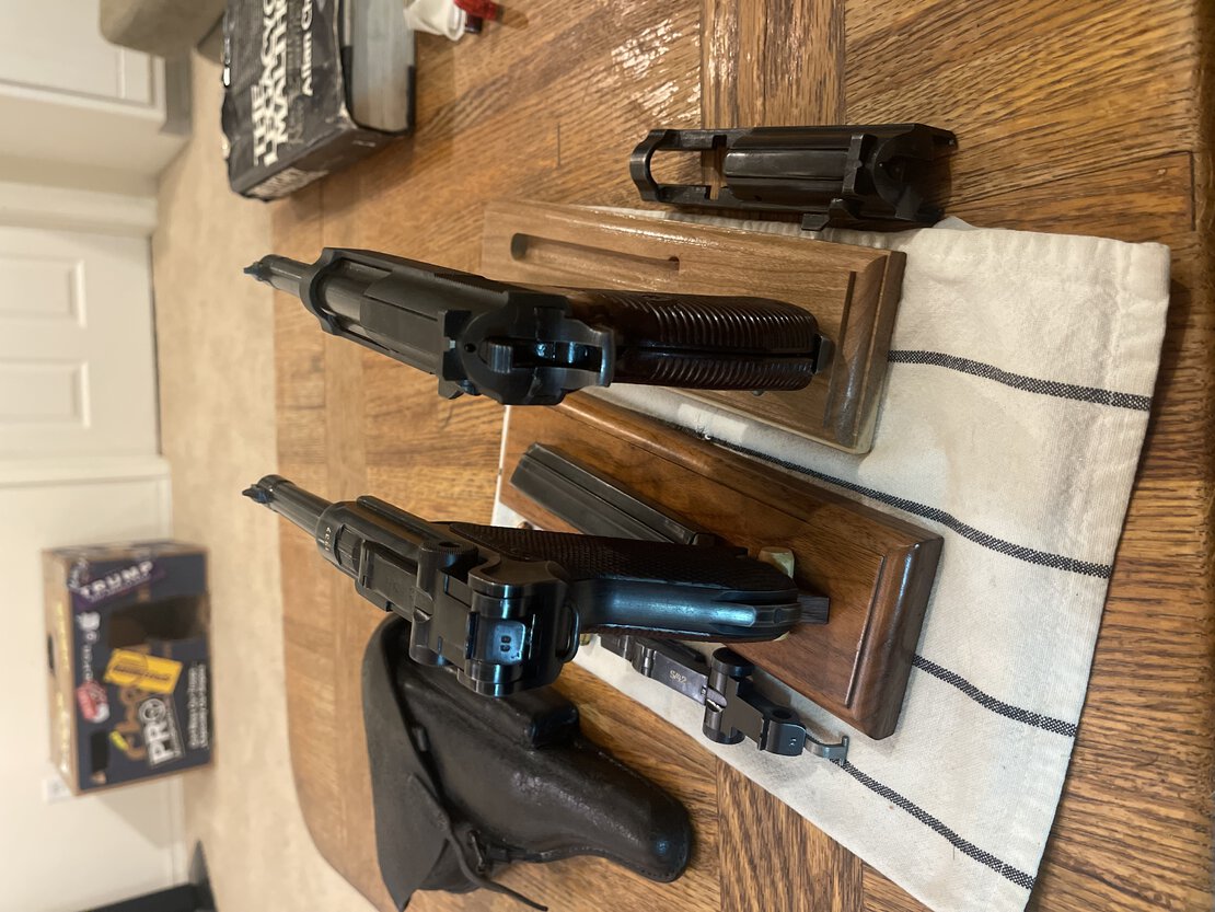

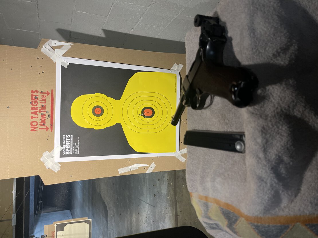

Default Toggle breakage
I was taught by the best on our forum how to avoid this and enjoy shooting it without concerns. I picked up a complete S/42 toggle assembly and slip it in. I used blazer brass at 1090 fps and these can be tack drivers . I shot first time at 21-23 feet with my late 37 S/42 . I spent about 250 for it and can use it in all my Lugers
File Type: jpg 75290364463__09F50EDC-1232-485B-937A-AF6EC577CDC2.jpg (186.5 KB, 2194 views)
