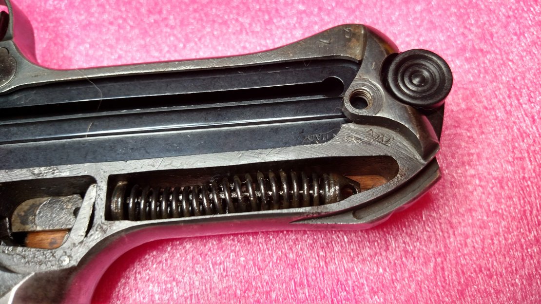

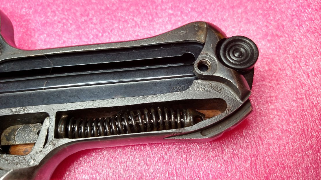

If you check our Luger FAQ document, you'll find the various recoil springs that were used in Lugers.
I also thought you might have a spring that was too powerful when I saw the pictures.
I found a "sticky" with mainspring ID and a chart, didn't see anything in the FAQs, if you could provide a link would be grateful.
Trying to ID the number of coils I have. seems like 20 but gets a bit dicey on the last turns... is it another 1/2, two halves make a whole? So 21?
RickW on another post mentioned he swapped all his mainsprings for #38 from Wolff.
Would like to ID my spring, (if able) and see what poundage it has. According to the chart on the sticky the lbs were much greater than 38 in older/original springs.

The Wolf spring rating and the "German" spring rating were obvoiusly done using different techniques, A 38 and a 50 lb spring are not the same- unless the measuring technique is different.
I have measured the three pack of Wolf springs before, and found them all to be essentially the same "weight"; in fact the spring labeled weakest, was stronger than the one labeled higher.
This one reason I say do not change springs unless you really need to, one does not know if a different spring will improve or make worse any particular condition. When you have handled a lot of lugers, you can tell by the strength needed to charge it, whether or not it has a strong or weak spring! Experience is the best teacher, keep on with your testing for sure.
You can measure diameters and count coils, and segregate springs for trial (and error) that way.
Whether you count 20.5 or 21 is not significant; are the ends ground flat? or left raw? this affects the over all length and coil count slightly.
Don't over think the spring - DWM could not decide which to use either. Sometimes the .30 and the 9mm were different, other times they decided the same spring was ok for either.
